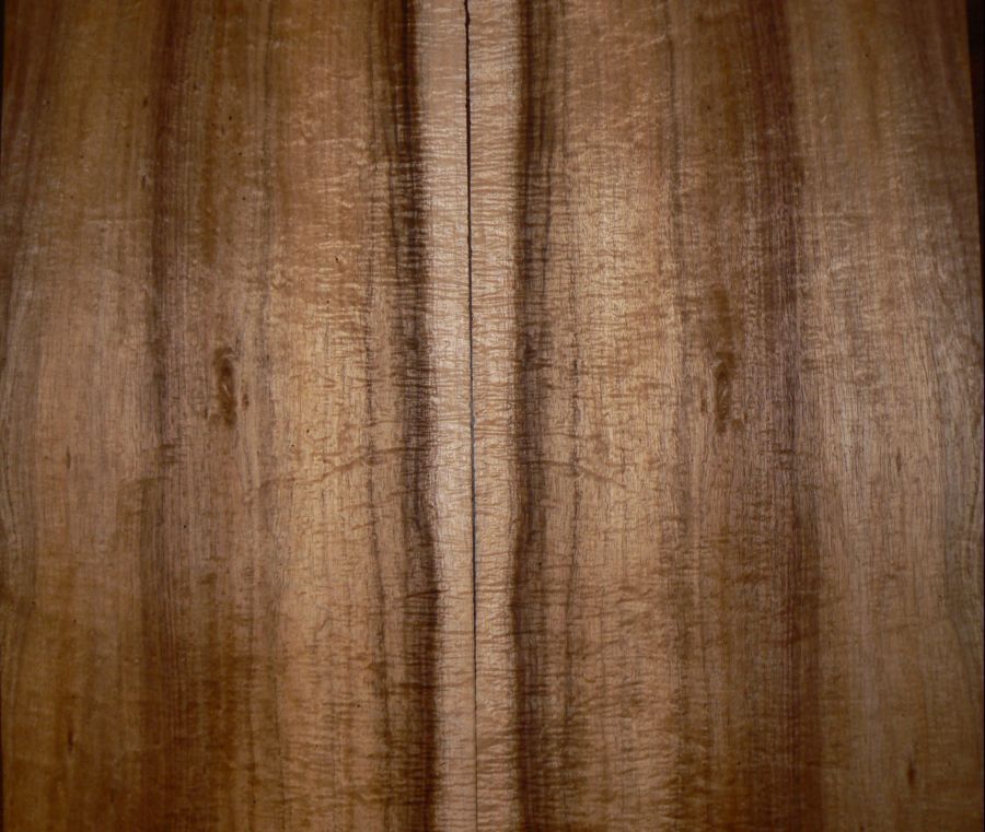

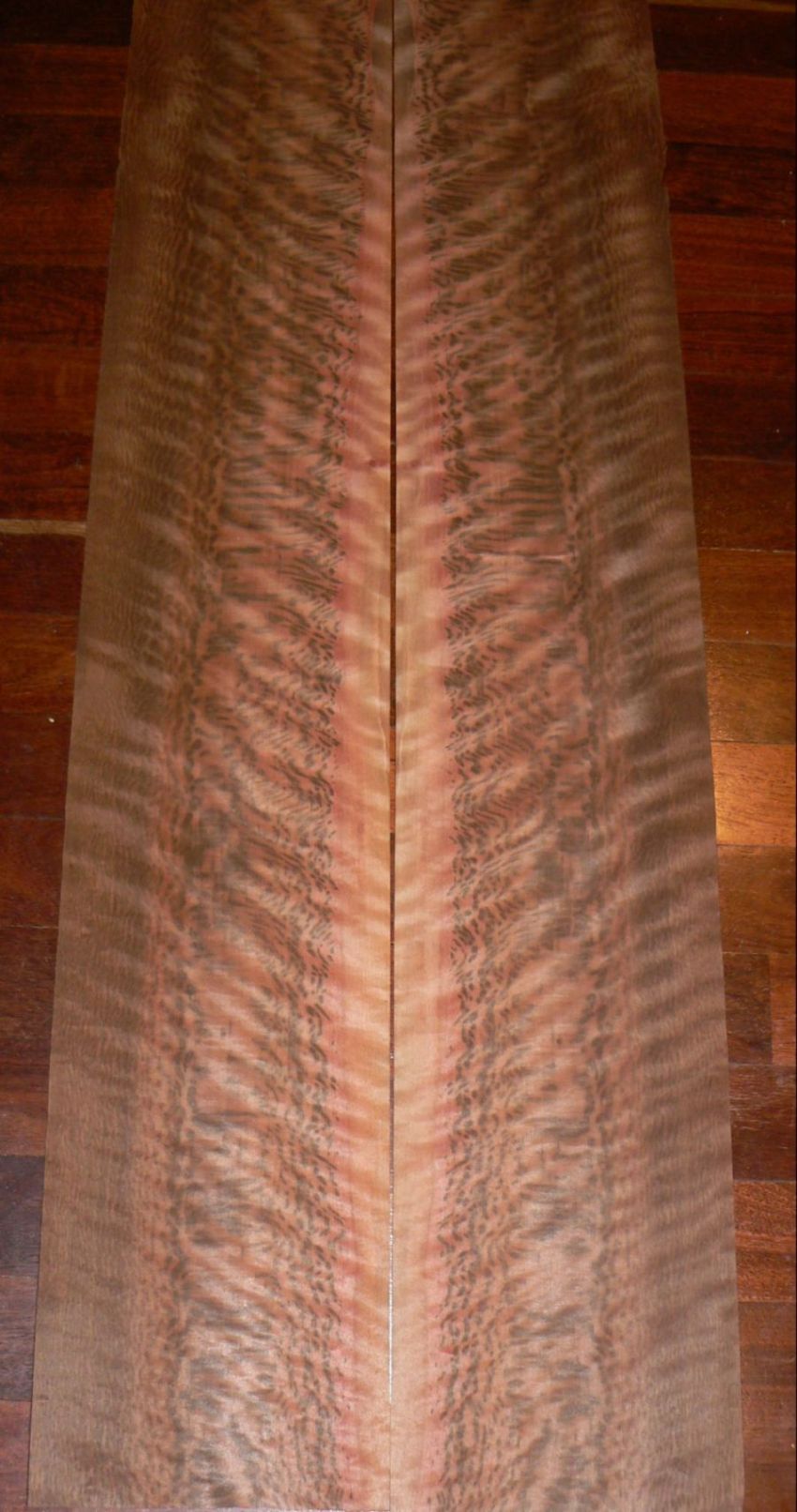

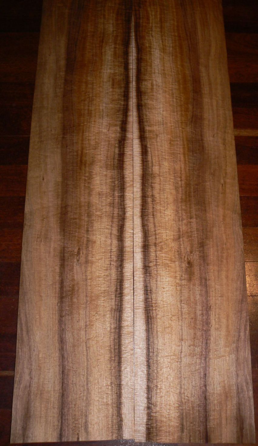

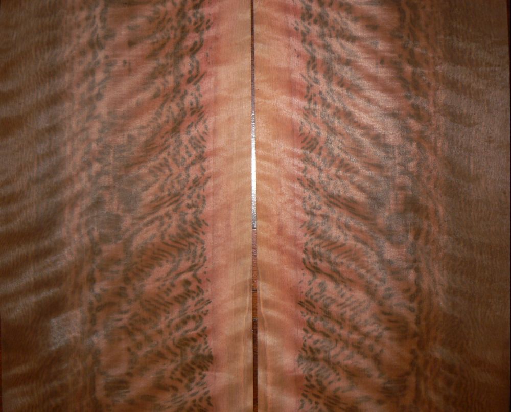

An opportunity exists for any forum members to advise me regarding preferred veneer thicknesses for laminated sides and backs
I have the option when milling and resawing logs to aportion some fo the material to be processed into veneer so that you can have matched laminated sides in combination with solid backs. Alternatively you may want veneer for backs and sides.
Here are two samples of the type of veneer I was going to utilise.
In any event if anyone has any information reagrding veneer thickness and possibly final side wall thickness I would be happy to hear from you.
regards
Tim
